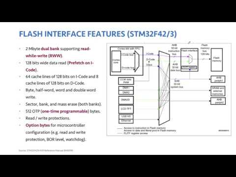

محتوى الفيديو
00:25 - Flash memory technologies
01:50 - Flash memory technologies (NAND-flash)
03:02 - Flash memory technologies (NOR-flash)
04:21 - Flash Interface features (STM32F42/3)
09:27 - Dual bank Flash organization
10:29 - Flash Latency
11:45 - Flash access control register (FLASH_ACR)
12:11 - Adaptive real-time (ART) memory accelerator
14:00 - Instruction prefetch
17:29 - Flash access control register (FLASH_ACR)
17:48 - Erase and program operations
20:07 - Flash key register (FLASH_KEYR)
20:12 - Flash control register (FLASH_CR)
20:24 - Program/erase parallelism
21:45 - Flash control register (FLASH_CR)
21:56 - Flash Erase
23:17 - Flash status register (FLASH_SR)
23:25 - Flash control register (FLASH_CR)
23:53 - Flash Programming
24:49 - Programming errors
27:26 - Flash status register (FLASH_SR)
28:31 - Flash control register (FLASH_CR)
28:52 - Option bytes
30:41 - Programming user option bytes
31:39 - Flash option key register (FLASH_OPTKEYR)
31:47 - Flash option control register (FLASH_OPTCR)
32:24 - Read protection (RDP)
37:10 - Write protection
38:22 - Proprietary code readout protection (PCROP)
