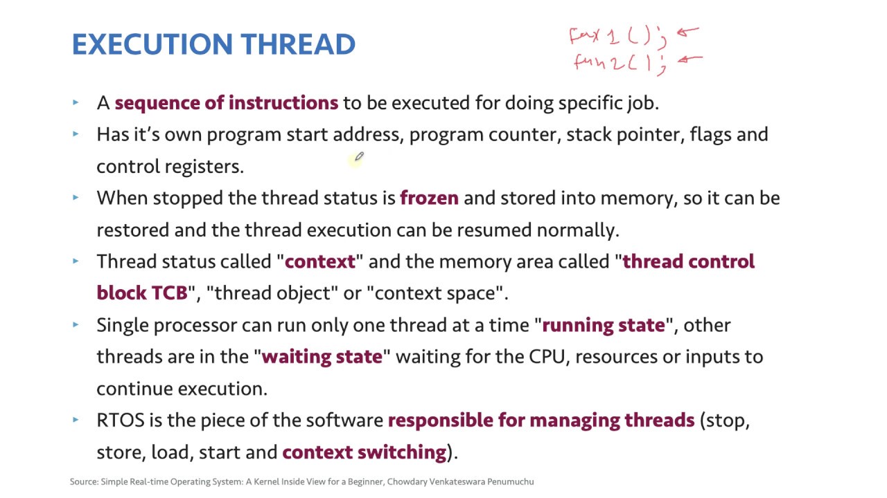

15:23 - Execution Thread
23:35 - Thread Control Block (TCB)
24:50 - Thread states

59:45 - PendSV (Pendable Service Call) exception
