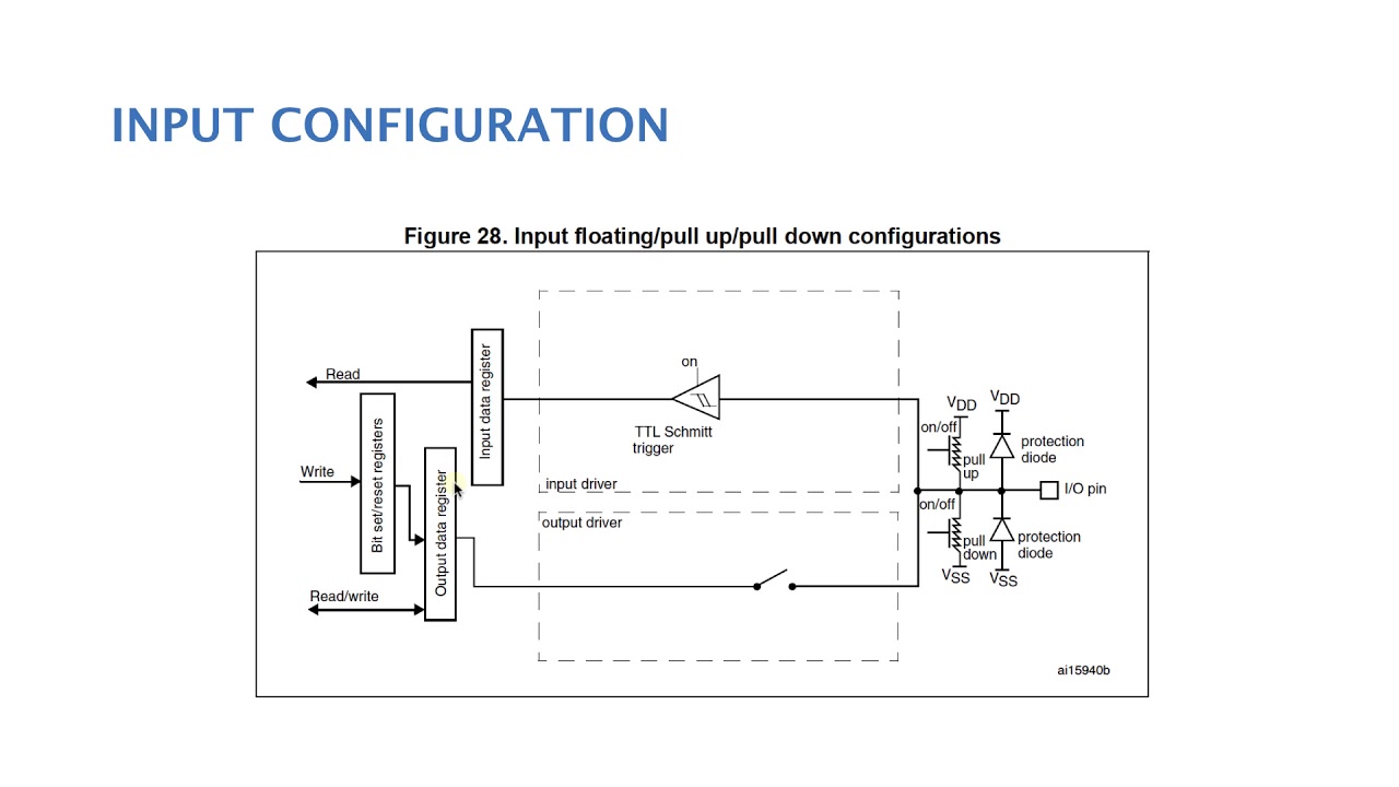

GPIO Pin Basic Structure
Input, Output, Analog and Alternate Function Configurations
