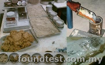

Soil sample would be collected from site and sieved to determine which type of Compaction Test is suitable. During the compaction test, the soil sample is compacted in mould by using a rammer. For Standard Proctor test, this step is carried out using a 2.5kg ram and soil is compacted in 3 equal layers while for Modified Standard Proctor test, this step is carried out using a 4.5kb ram and soil is compacted in 5 equal layers. This step will be repeated few times with a different moisture content added to obtain a series of data

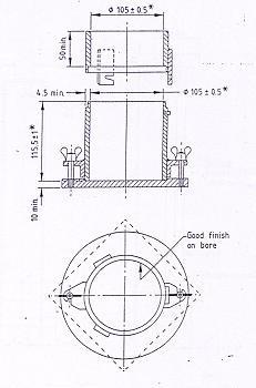

2.5kg Rammer
4.5kg Rammer
1L Mould
